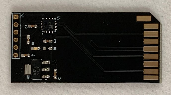

This is the device I was referring to
And yeah kind of, there’s two rails being provided for the EMMC IC, one is 3.3V and the other is 1.8V, in this case the dev is applying 3.3V to both inputs.
The device itself is basically just an MMC/SD controller, if the dev resolved the issues I mentioned it’d be perfect.

yes i would much rather work with some kind of emmc reader device and a pc instead of doing any kind firmware mod to the Switch
i can see how the first device would be useful, but in this specific case i can see what your saying that it could potentially do more damage than good,
