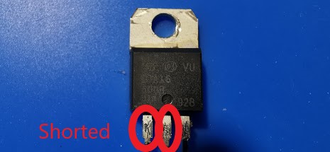

Rework Station 858D fuse blow and heating element burnt out
the front 7 seg lights up, the front panel and control work when I last tested it. I believe the fan speed works too.
I have tested the triac (bta16-600b) out of the circuit, from left to right pin ( the left 2 pin has 0 ohm and continuity beeps) (attached picture)
it is a 110V ( so it says at lesat haha)
which one is the thermocouple or thermistor ?
