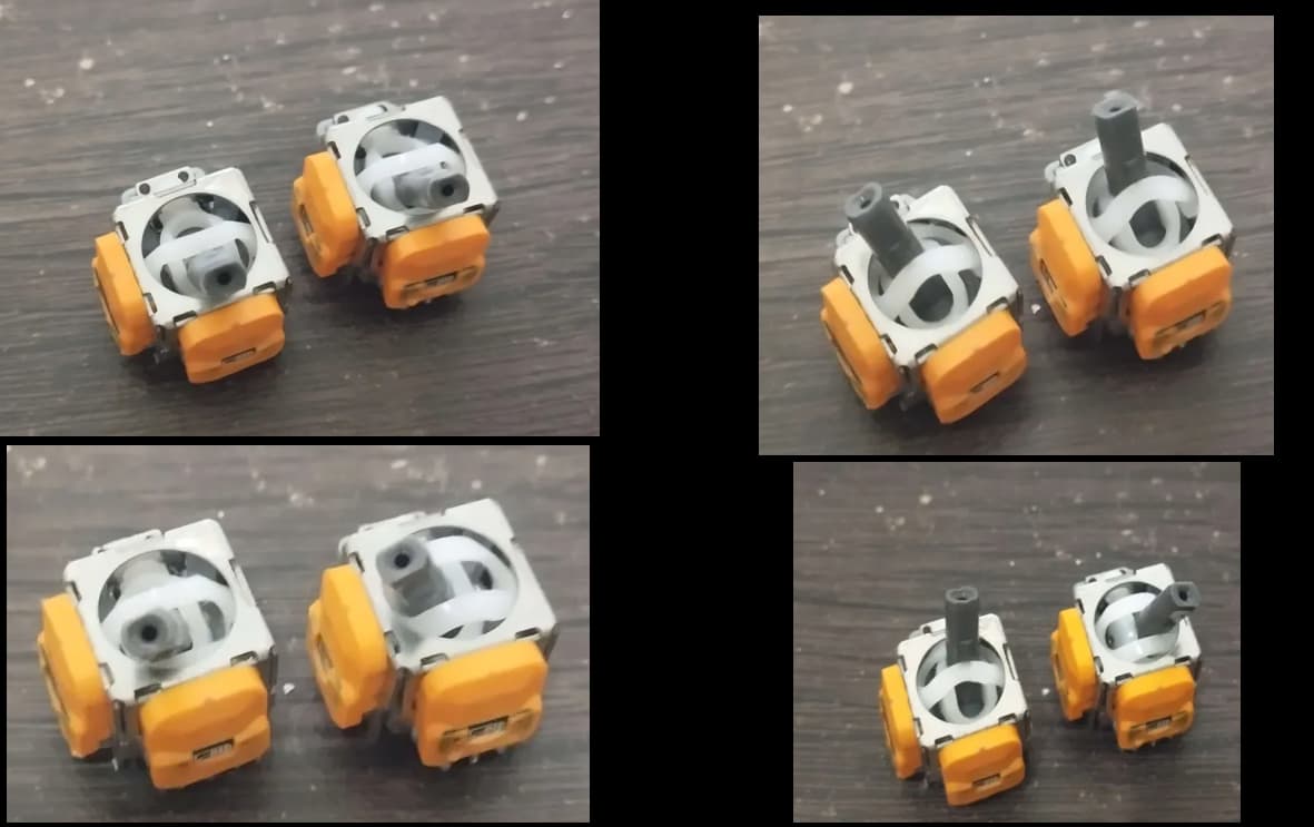

The magnets and sensors work fine, the spring in the middle that is pushing up on the stick to center is being stuck, also the original solder is so hard to melt and I dont have money to buy professional grade tools soo… 450C should be enough yet it seems like the solder melts at 470C cuz the one I have put there from my spool melts at 450 as it should. I tried multiple ways to put links but none worked… imma try to paste it here with spaces or something.
Okay so link for the image on what is happening is
ibb (dot) co/2sPvtz8
You can see the problem there… The tracking on the stick is still good, the only thing is that it does not center like if the molding for the middle piece was bad or something… Sticks came in a plastic box so its not like it could have been damaged in shipping… I think they may have received a bad batch and I just purchased it at the wrong time… Cuz the other normal sticks from the same seller worked fine but I feel like it will be drifting again in no time like the original were… So that is why I wanted to try out hall effect sensors…
And yes the one to the right is slightly melted because that is the one I openned after I removed it and sticks almost always melt when I try to desolder them cuz the board is just hot. And I dont have a tape that would shield heat since I never needed such a thing for any repairs.
I have already done that, magnets are in there moving freely… Its not the sides that are stuck, its the spring inside that is pushing the plate on the gray middle part of the stick that has the thumb stick on it… that middle piece, it looks like a plate with 4 edges that are supposed to move in 4 grooves but it is being stuck in them grooves and spring aint strong enough to push it back so the white pieces would center…
