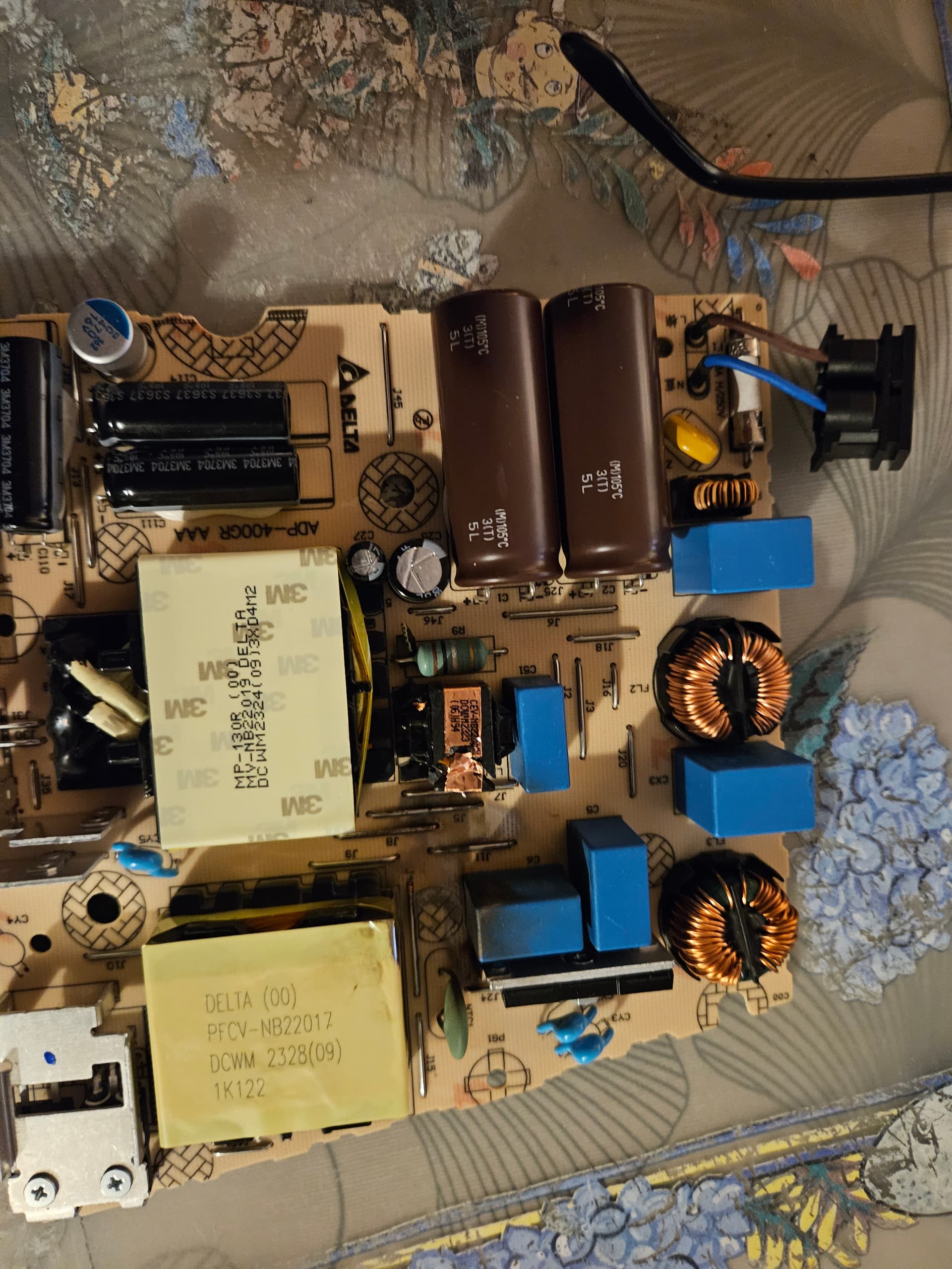

I need help finding a reference for the blown transformer in the adp400 gr power supply of a slim. This is the small transformer next to the blue component in the photo.

Most inductors and transformer inside PS5 PSU are custom model. You cant really find/buy it from regular sources.
ok thank you if anyone has this part I’m interested :wink: we can’t find it on another type of power supply?
on peut faire fonctionner la console avec une alim de fatcan we operate the console with a fat power supply via cables to check that it is really the one?
THANKS
fully boot up PS5 (1000/1100) required around 12v 8~10Amp, you can test it via cable directly connected to 12v main port on motherboard
ok thanks i will do that;)
