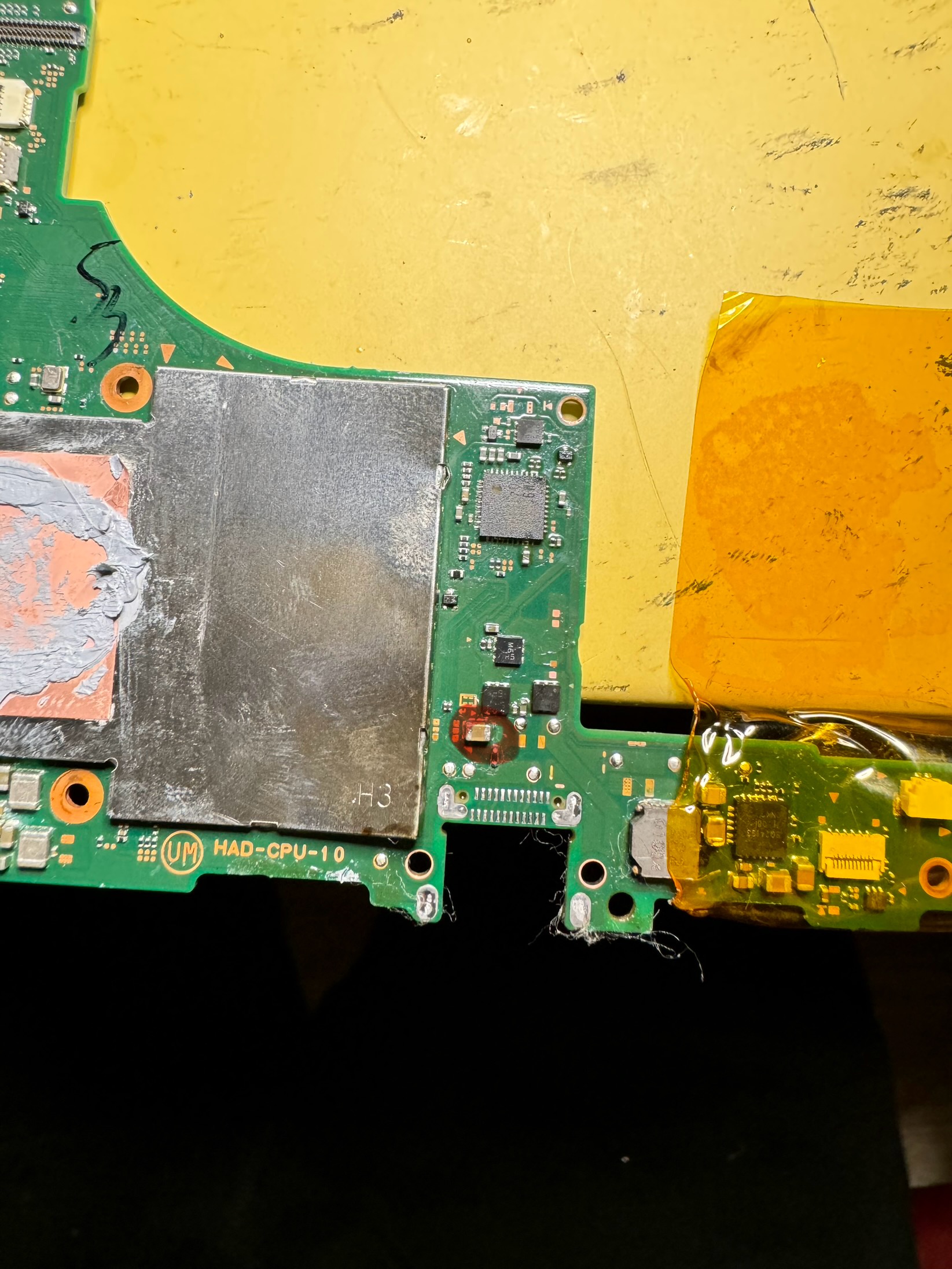

Identify Capacitor near fuse on HAD-CPU-10 (V2) Board
This larger capacitor near fuse/FL1 is shorted and i need to replace it, i removed it from the board and its shorted. Can you please identify this part so i can order a new one thanks.

I would use a 0805 10µF 20V cap
