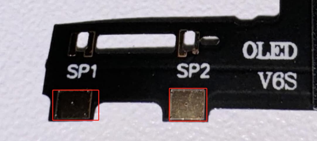

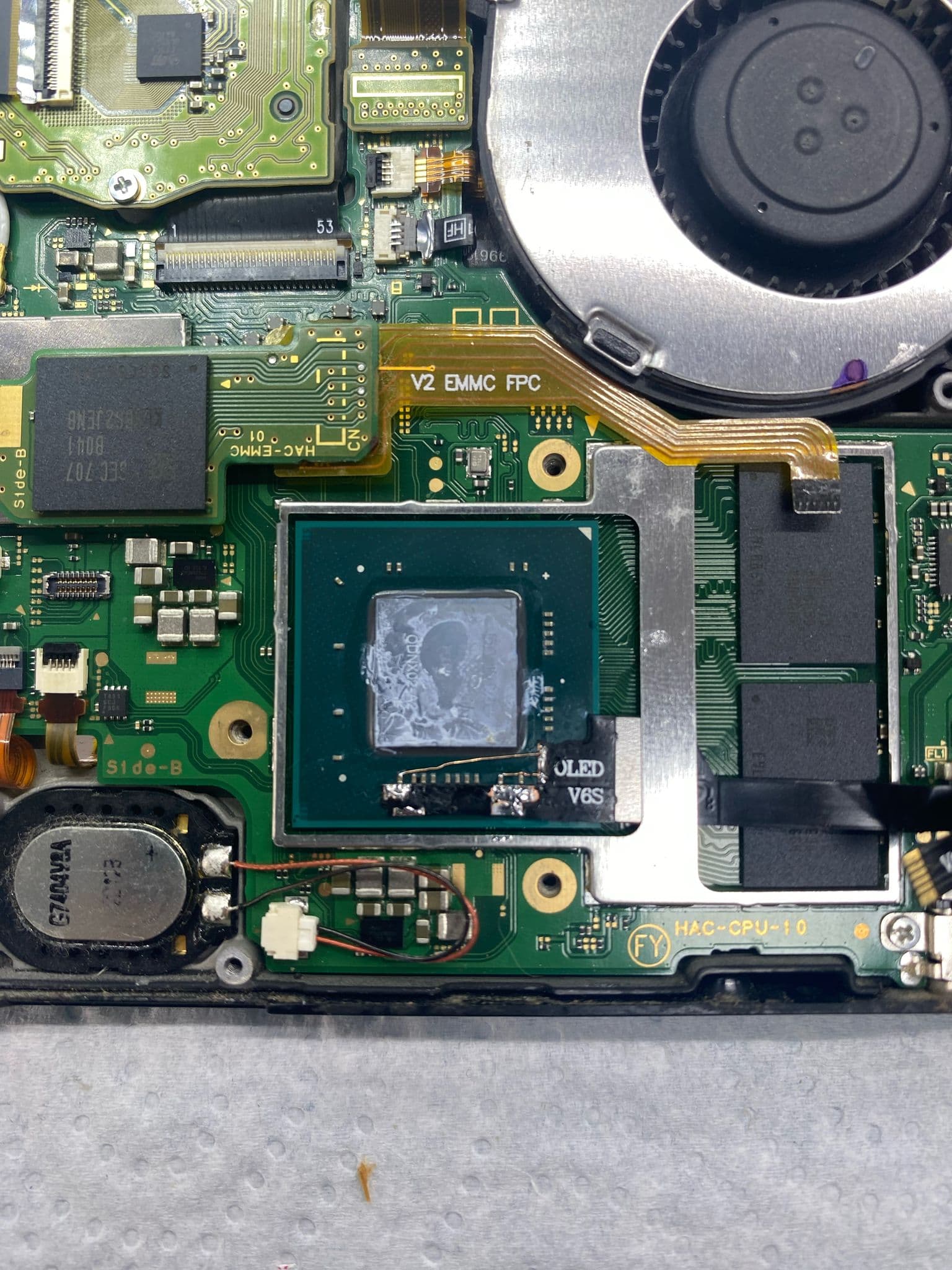

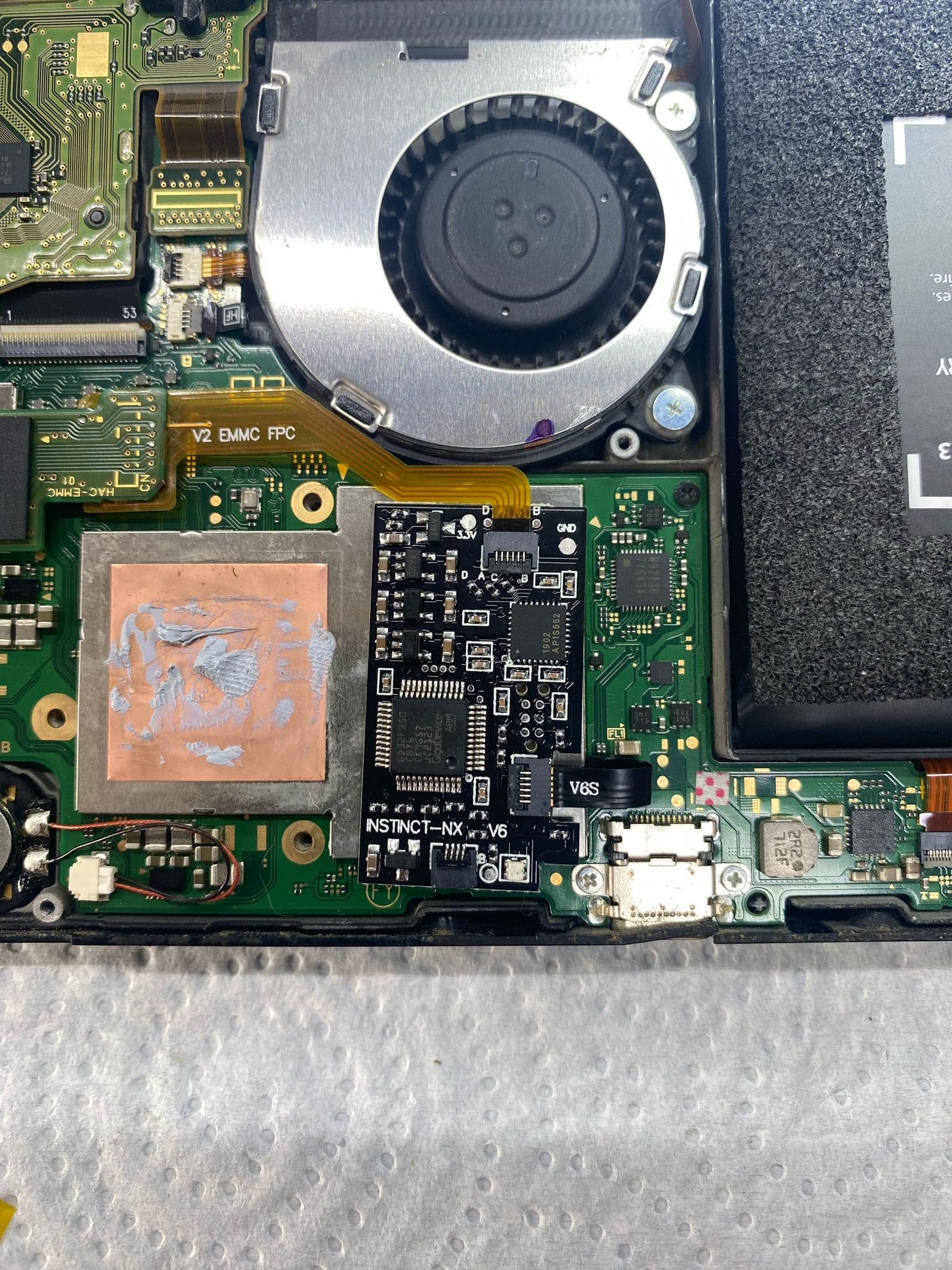

Hey guys, can you tell me if this chip is compatible with the Erista V1 versions? I can’t get the chip to boot; it’s an infinite glitch. I’m using the flex for the OLED switches.

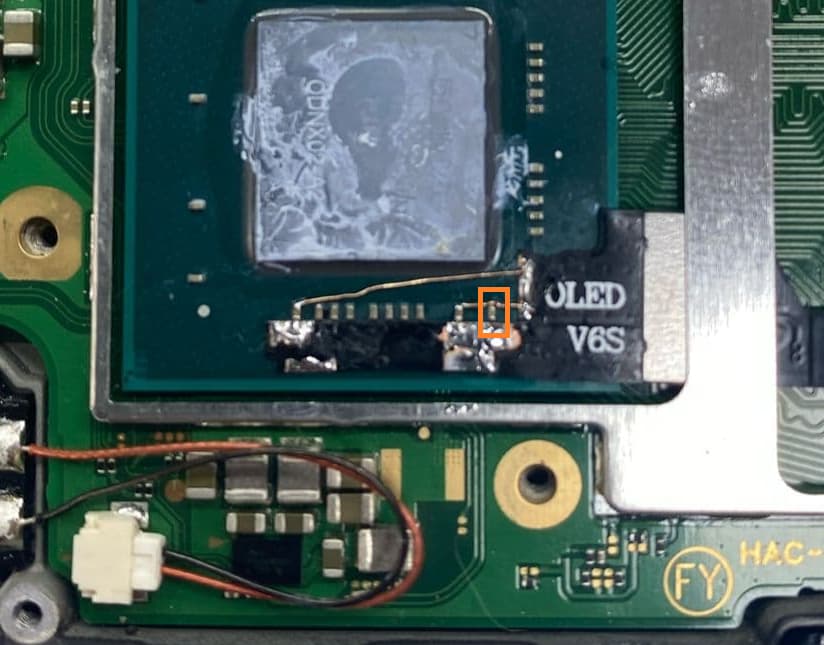

How do you managed to solder the S1 S2 ribbon flex correct to the SoC?
ground is not connected from the CPU flex I believe, the bottom square part should be solder on the metal shield but you have it cut
That’s just protection so it doesn’t move, I’ve also tried with the ground connected
It is enameled cable, it does not make contact.
It must be a problem with the contacts, in V2 it works perfectly, I think that chip is not compatible, all the instinc chips that are sold are for V2/lite/oled, for V1 change the chip which is the core.
