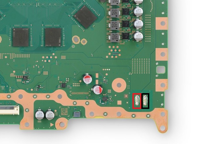

I would open the PS5 and check if 12V are delivered at the psu pins on the mainboard.
How do I locate the PSU pins?
red +
blk -
they should show 12V
I tested the psu and I get no reading from the psu.
It is possible that a short on the 12V at the mainboard is forcing the psu in safe mode. So I would take the psu out and check the psu direct for 12V or the terminals on the mainboard for a short.
If the psu is still not putting out 12V, you have found the cause for the defect.
