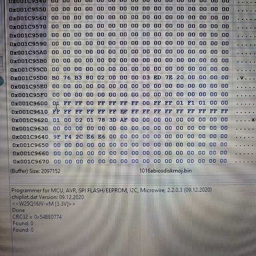

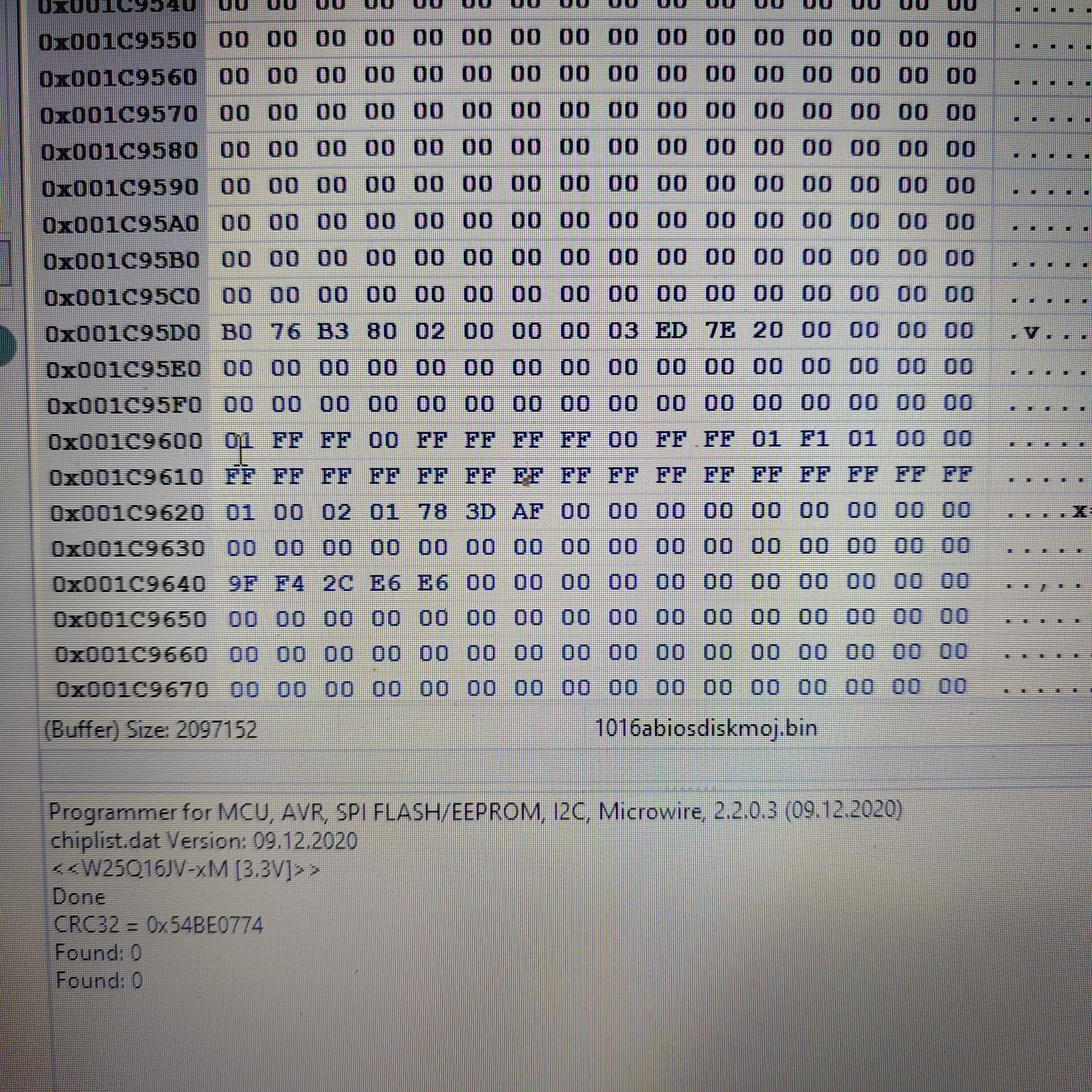

Seems like I found my bios. Can you please just check if that’s the correct dial?

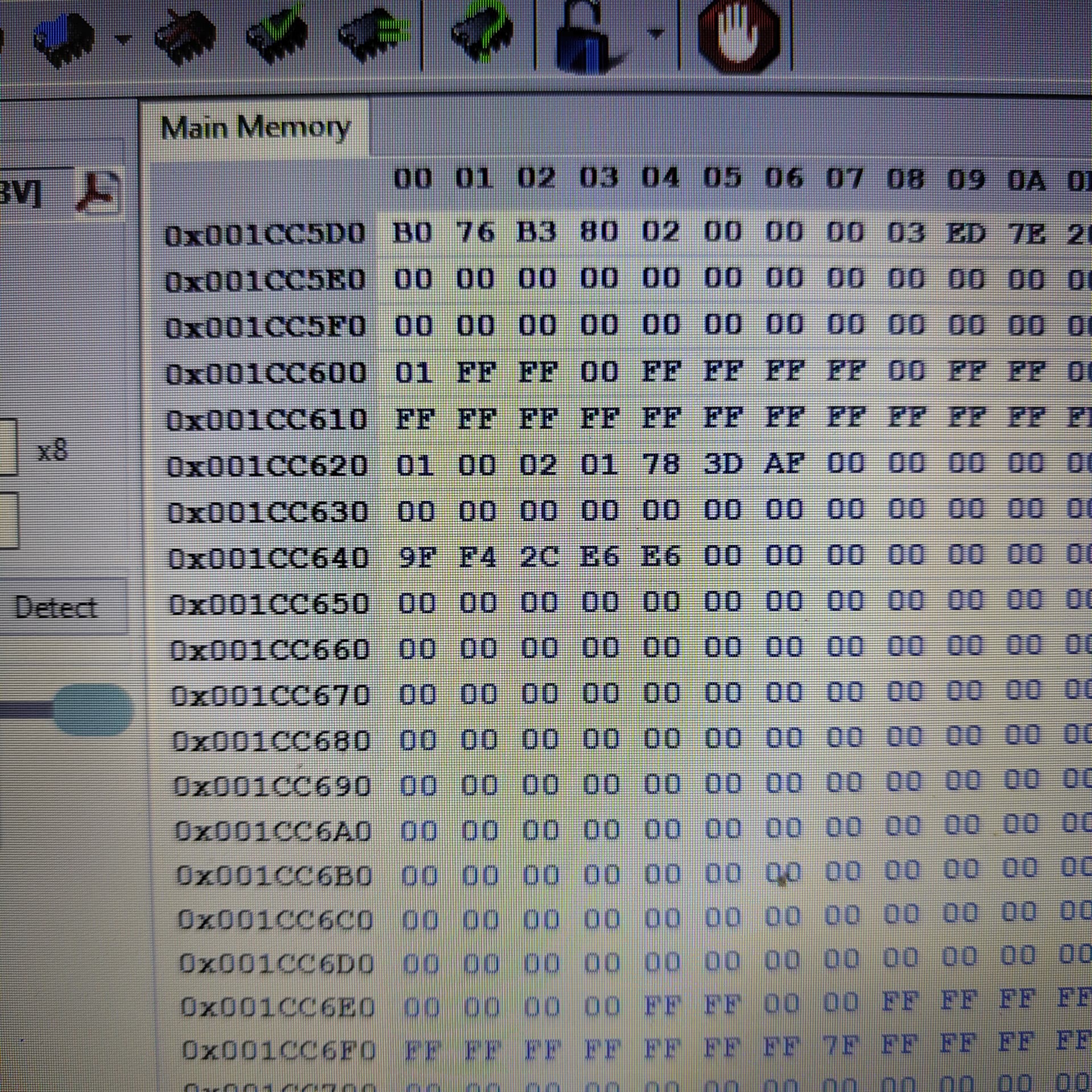

Can’t believe I didn’t check that before, I had no clue that there’s 2 spots I need to check when it comes to IDU mode.
I need to change all 01 to 00 correct? Same with 01cc600?
Well, I did change the bios to original one, changed both of those bits but unfortunately, still CE-105628-2. Any other ideas?
