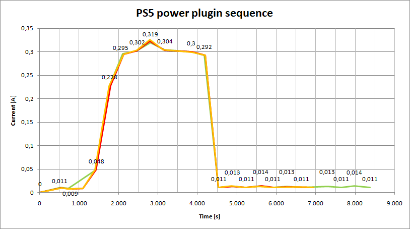

If you enable the power supply, what is the sequence?
~8mA is normaly at the end of this sequence.
The sequence doesn’t start and go up to 300mA it just starts at 8mA and stays there

From a working PS5.
