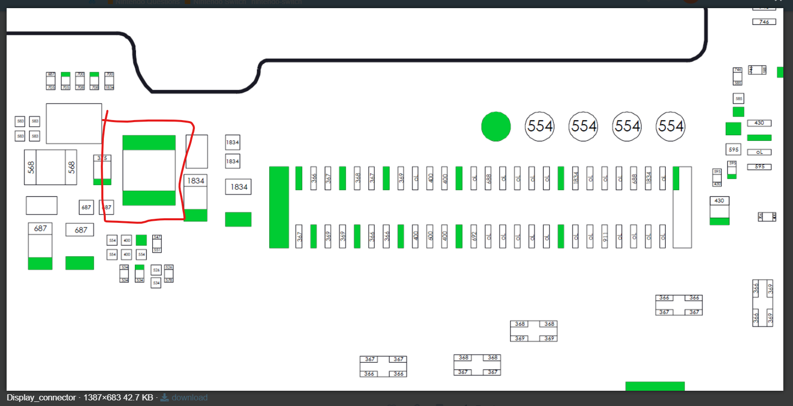

Hello all,
does anyone know the value of this coil?
A customer wanted to desolder the “shorted cap” and the coil broke. I cleaned the whole thing, but had no chance to measure the coil.
Unfortunately, I have no donor boards for the switch

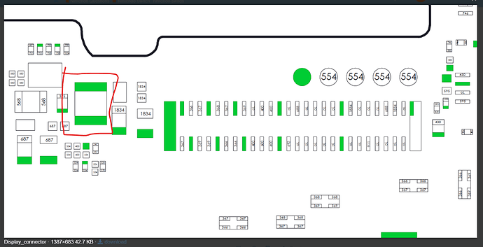

Hello all,
According to the typical application in the datasheet for BD8316GWL (Rohm), the both coils at this ic have 4.7 µH.
