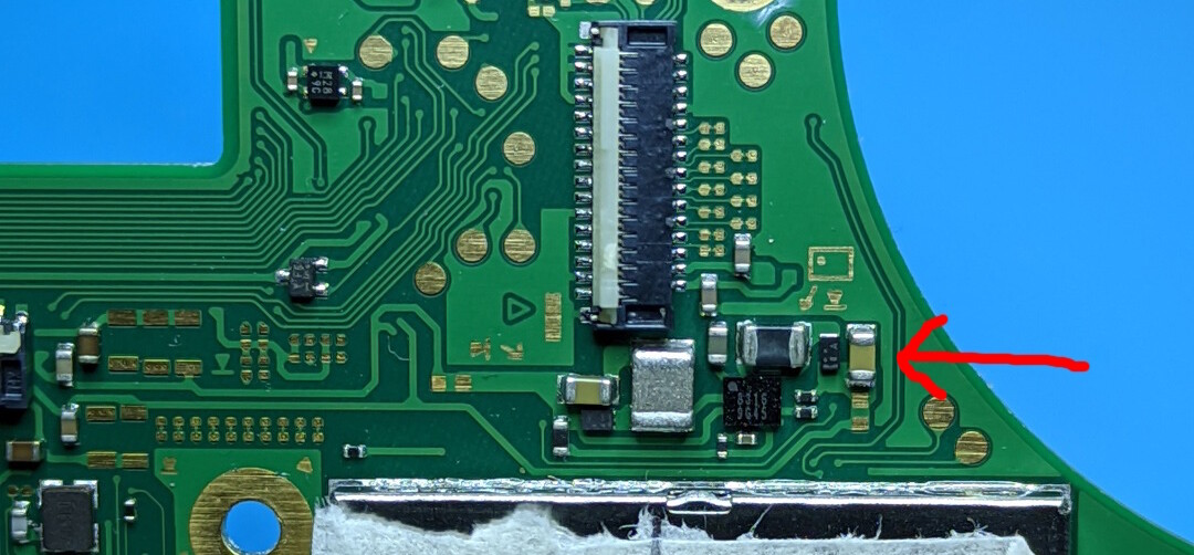

Can some measure this capacitor and let me know the value. This is located to the right of the card slot ribbon connector. Any help greatly appreciated
upload://5b39UZrmmCHy5I5tCwyQ1AruooS.png)
Cant figure out how to attach picture
Anyone know the value of this capacitor?
0805 (<-- please check dimensions) 4,7 µF 10V
Thank you so much. I really appreciate it. I asked the same question over at gbatemp 3 different times and got nothing. Again, thank you.
