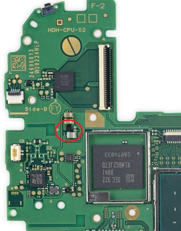

CHECK THIS area if any damage on the ic
hello. i checked this area… everithing looks fine… even checked the connection with multimeter (as good as I knew honestly). everything looks fine… the only thing I didn’t check is the black small chip in the middle
