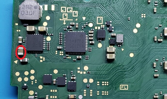

Switch lite lost cap near BQ24193
Hi. I lost this big cap during bq24193 ic replacement. Can you tell me its value?
Thanks.
From the datasheet for the bq24193 the cap should have 1µF and the size could be 0805.
That cap goes to pin23 with the 0201 cap, so should be 10uF instead of 1uF
Oh. Sorry, my fault.
