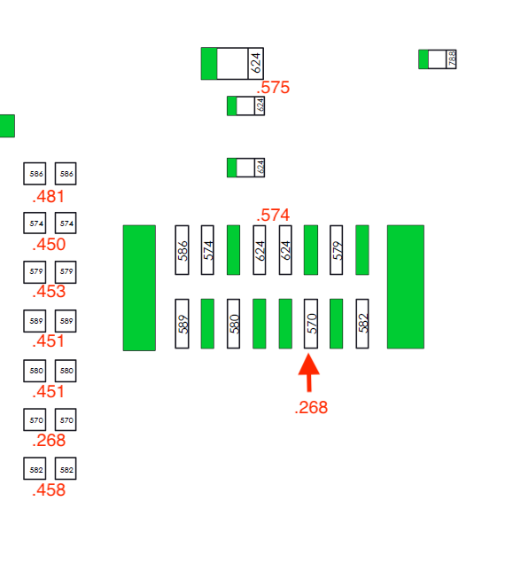

I have a HAD-CPU-10 board that is getting an error, “unable to read SD Card, restart the device” Something like that.
I noticed I am getting a low reading in diode mode on one of the pins, everything else in the area seems right, my values are in the picture below in red, suspect pin pointed out. I’m not sure where this pin goes, and was hoping for some insight, hopefully it is not the CPU.
Guys, where I can find a full diode readings diagram like this cut above?
