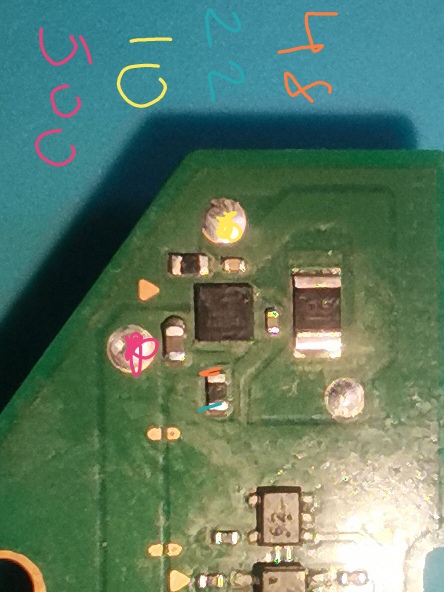

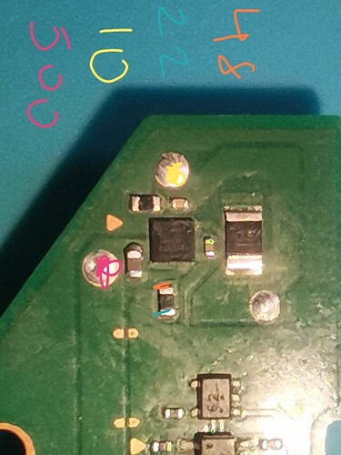

Hello everyone! Long story short. Switch oled with no power, without backstory. There are no shorts on board. I’ve tracked down issue to max 17050 due to retrosix guide, I have 0.17a from bench with instant drop to 0.12a. I’ve tried 2 ICs from donor boards, w/o any luck. However, I’m not quite sure if they are good, because boards are dead as well. So, now I got my hands on fully working oled, and I’m interesting if I can try max from it, but I’m kinda worry if max will die if anything else is broken. So does anyone tried this, and can give any advice? I also did some measurements in kohms
around 17050. Thanks in advance
