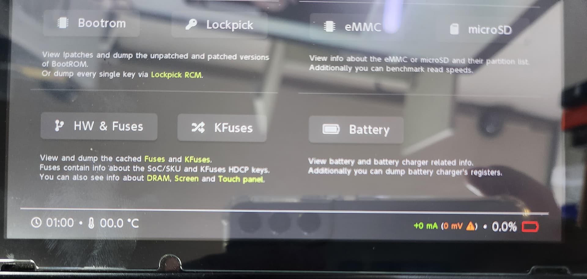

As shown in the attached photo, the battery information is not displayed, and the device fails to boot.

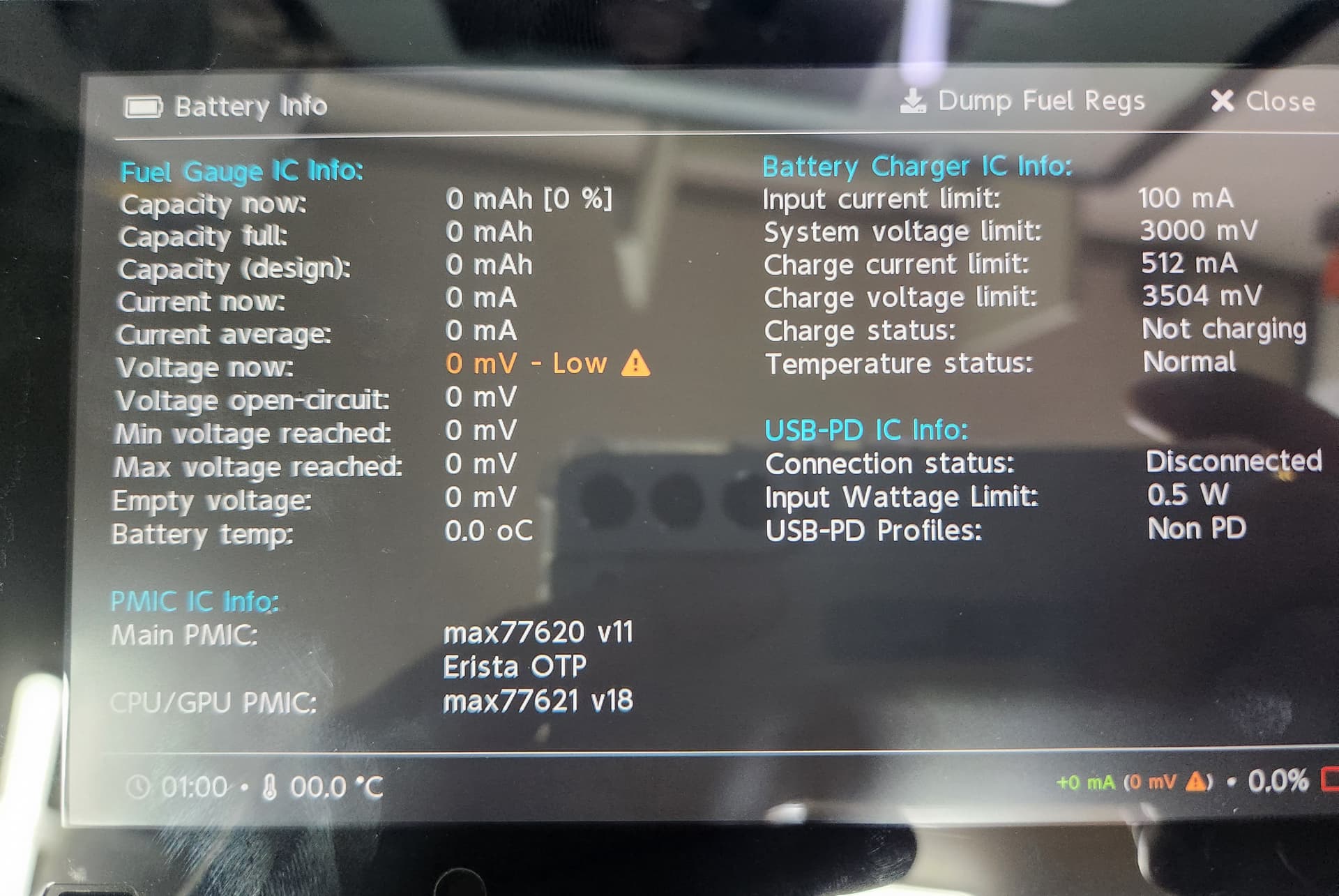

  1. battery infor no display
  2. even after replacing it with a fully chaged battery from other switch , the information is still not displayed.
