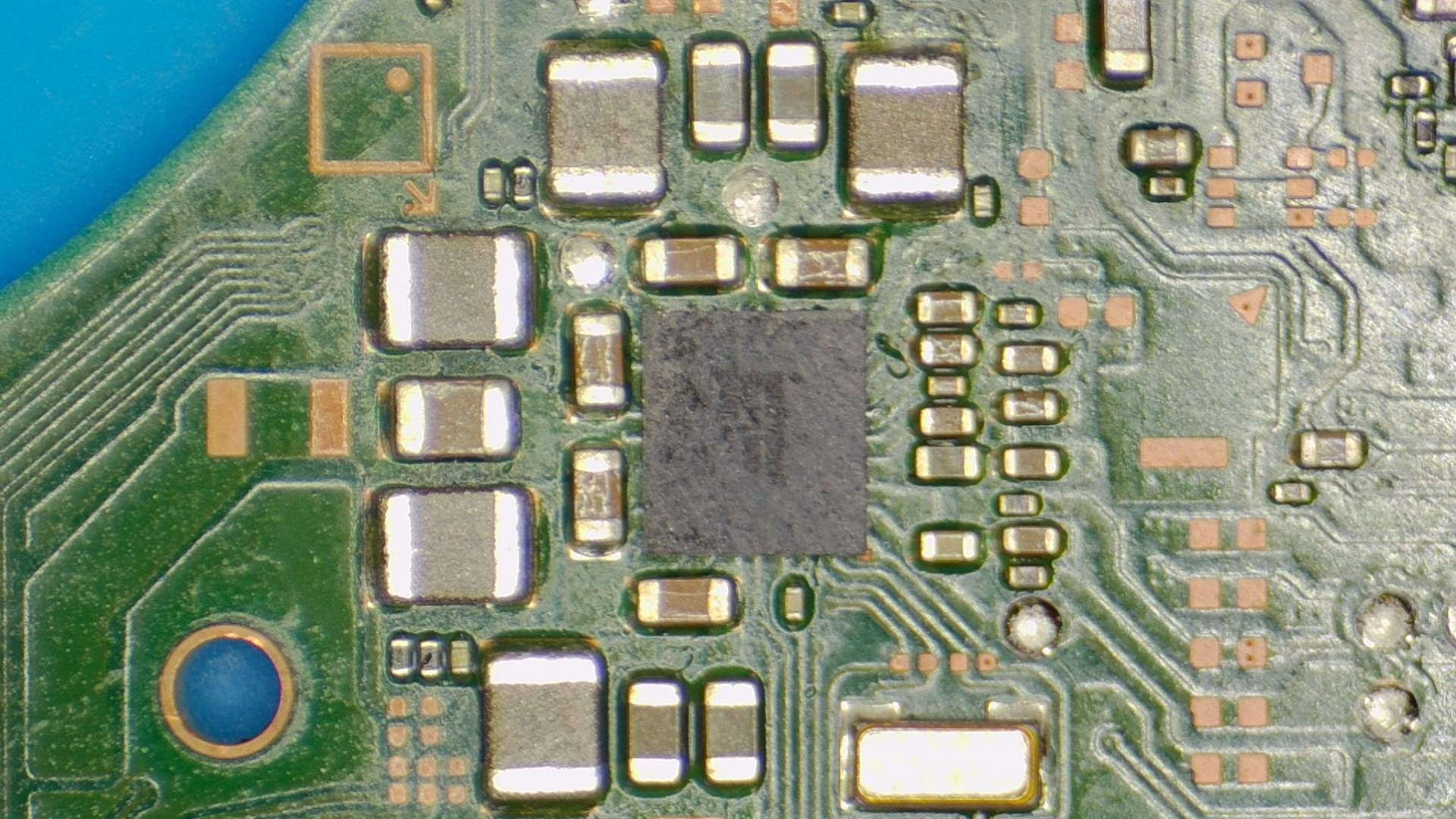

I have replaced both M92 and BQ. Still the same. No shorts on any of the power rails. On the front non of the MAX ICs are turning on. On the back I have 3,3V, 1V, 1,1V, 1,4V, 1,8V. There is no 5 V, and no backlight.
I cannot find anything comparing to a good board. It is charging with 15V 730mA. Are there any way to check if the EMMC is corrupted?

1,8V PDR above the MAX iC 2,6kOhm. 3,3V rail et ENXX IC few hundred kOhm and jumping up and down.
The 1V rail on the left of the MAX IC is 36Ohm on a known good board 53Ohm
Maybe it is just my USB meter. I used to see ~700mA on 15V with it :slight_smile: If I use a 5V charger that is either 450mA or 1,4A with the same meter.
ney good, try disconnecting the EMMC module and taking that reading again, you shuld be seeing approx 10k, failing that remove the M92 IC and retake the measurement your then looking for >10k after
Keep the EMMC disconnected going forward, such a low reading on the 1V8PDR will corrupt it.
Now I switched to my Fluke DMM now I measure 3,2kOhm with and without EMMC. But I measure the exact same on the known good board.
I measure on the top right inductor.
It’s no good good unfortunatley, should be approx 10k/13k depending on probe polarity, fluke or not, try letting the boards cool down prior to the reading, if you have a secondary meter to verify nows the time :wink:
